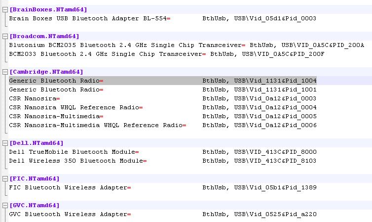

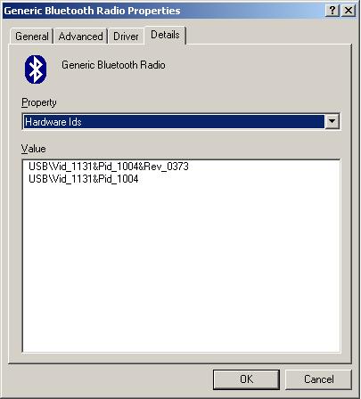

    Now right-click on My computer (dongle is already inserted) -> Hardware -> Device Manager. In the device manager window found your ISSCEDRBTA device and double click on it then select Details tab. Select property Hardware Ids. This will look smthing like this:
    Here you need this info: USB\Vid_1131&Pid_1004. Copy it with Ctrl+C. Now go open that bth.inf file and find there descriptions of devices. This looks like:
    Now find similar row and copy it and at last paste your dongle Hardware Id in there. That's it!
    Now follow the instructions in the first post by Nimrod.
