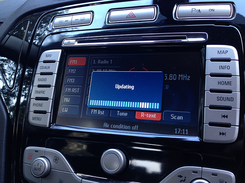

The illustrative photo in this guide shows me performing the update to my 2010 Mondeo's Ford/Blaupunkt NX touch-screen nav system, but it works with any USB-capable audio system (for example the Sony 6 CD/DAB unit) in any the vehicles listed below.

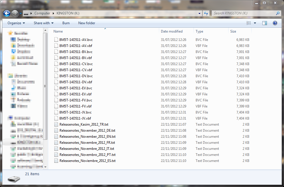

1. Download the update from here: Download Ford Audio Bluetooth / USB firmware update - November 2012 release
2. Format a USB memory stick, ensuring the file system is set to FAT32
3. Unzip the contents (all 21 items) of the zip file you just downloaded, and copy them to the root of the memory stick, i.e. without placing them in any folders. The contents of the memory stick should appear as below:

2. Switch on the radio WITHOUT turning on the ignition
3. Insert the memory stick into the USB socket
4. If nothing appears on the screen, switch to the AUX/USB input. You will then receive a message stating that there are no media files on the device.
5. Now switch the ignition on but do not turn the engine on. If you don't have keyless start, turn the key two clicks to turn the ignition on. If you do have keyless start, press the button WITHOUT depressing the clutch (manual) or brake (automatic).
6. Now the radio should initialise and perform the update. It will display "Update running" (or words to that effect).
7. DO NOT switch off the ignition, or switch on the engine during this time. The update will take up to 20 minutes to apply, and it feels a lot longer if you're sitting watching it! Now would be a good time to make a cup of tea.
Once the update is finished, you will receive a confirmation message on the display briefly, and then it will switch back to radio playback. Power off the radio, then power it back up again and check the USB and Bluetooth functionality.
