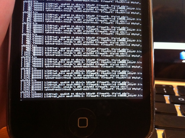

    everything worked fine, till this moment:
    I don't know what is wrong, I tried two times and the result was the same.
    My devices:
    -iPhone 3G 3.1.2 redsn0w
    -PS 3 FAT 40GB 3.4.1
    I hope that somebody will help :)
  4. xzKinGzxBuRnzx
    xzKinGzxBuRnzx Moderator
    1,873
    1,237
    You're both waiting to long. if you notice, that doesn't even display on my iPhone. So check to make sure you pressing everything when you're suppose to and that you've removed all other usb cables from the device. Plus unplug it or hit the switch. Then turn it on after it begins displaying INIT. I don't understand how people are having issues here, this is the easiest part!
    INIT is displayed right after it says ****************************LOADING FIRMWARE************************************
  5. micpli
    micpli New Member
    Sep 30, 2010
    3
    Fine, I managed to do it!
    Thank you :)
