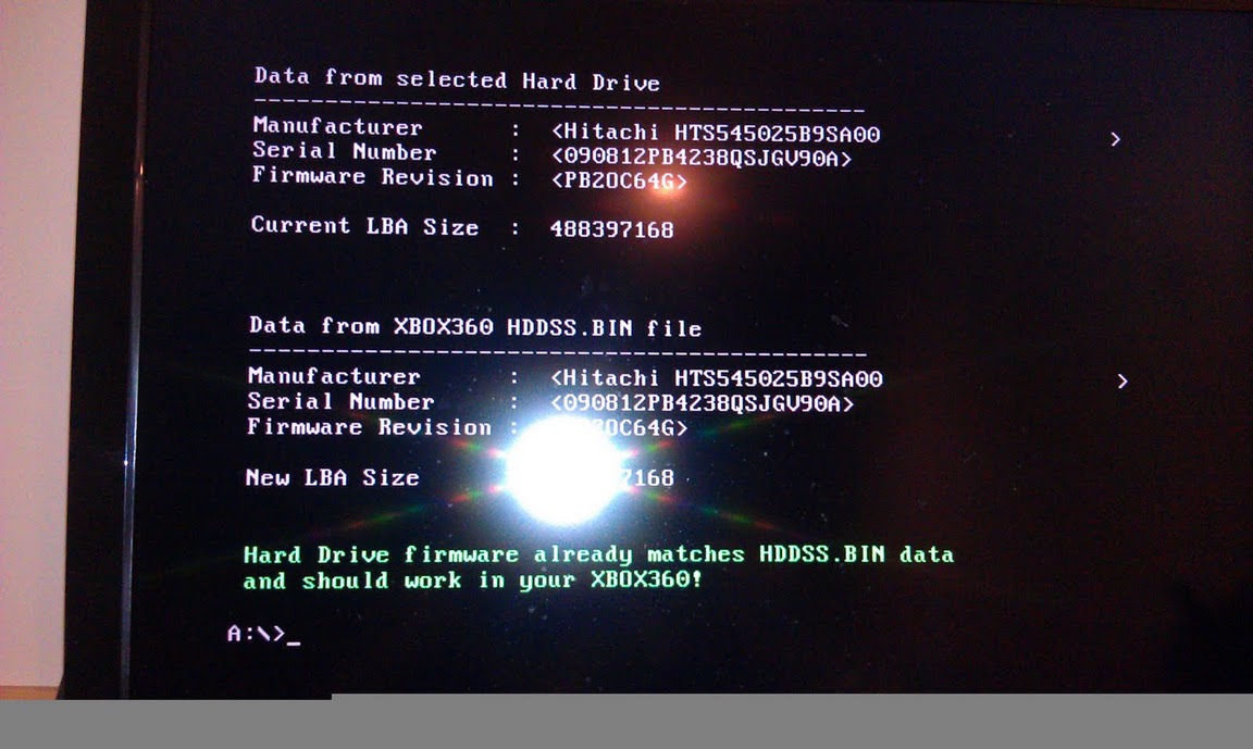

  13. Ben Ferguson
    Ben Ferguson New Member
    Jul 2, 2011
    Probably already asked... but there's a lot of pages and i may have missed it
    I have a WD Black 2500 BEKT and I have followed the tutorial as carefully as I could but when I put the drive in my Xbox, it wouldn't recognize it and I couldn't even find it in storage devices.
    I tried re-flashing the firmware and it says it already matches and should work... any ideas?
  14. Rick
    Rick Moderator
    2,852
    1,288
    if you are using the version 1.3 re run it and select create partitions this time and it should work
