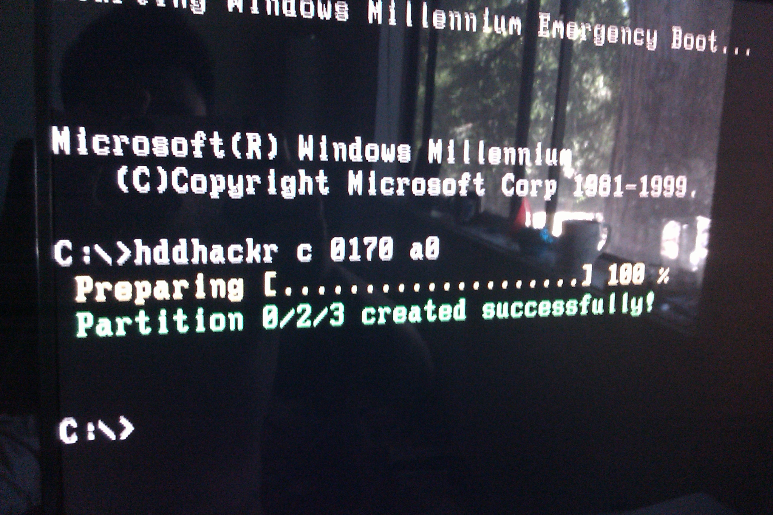

    I followed the directions and everything worked but my xbox is showing that only 789mb out of the 250gb is available. I would greatly appreciate if anyone could help me fix this.
  18. Rick
    Rick Moderator
    2,852
    1,288
    format the drive in the memory section of the xbox.if it shows around 250 gb then your set.if not then follow below

    So I just flashed my 250gb WD Blue Scorpio WD2500BEVT successfully and I now I am a little stumped. I own a 4gb 360 Slim and I was wondering how I would go about transferring all of my things to my new hard drive. Do I have to put my new hard drive into my 360 and format it first? Or do I have to use that partitioning program first? Also, since I already have a newer Xbox 360, does it already come with the ability to play original Xbox games once I partition and format or do I need to do something separate to get that?
    EDIT: I just went over the steps again and I don't think I was prompted with making partitions after I flashed it..
    I followed step by step these instructions: http://youtu.be/VRanCwITI5A and I was not prompted to add partitions, is there something I missed?
  20. Rick
    Rick Moderator
    2,852
    1,288
    re run hddhackr and use the partition option.
    you need to copy partition 2 using xplorer 360 if you want to play original xbox games
    read the first page so you know exactly
