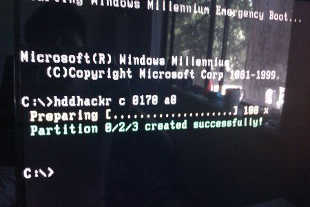

  18. mnkeyprince
    mnkeyprince Member
    Jul 18, 2011
    16
    4
    yup, the harddrive didnt partition, halo 2 and forza wouldnt play
    how would i parition the drive when hddhackr didnt ask me if i wanted to or not.
    is there a command i could type in MS DOS?
    should i reflash my harddrive first then partition?
    thanks
  19. mnkeyprince
    mnkeyprince Member
    Jul 18, 2011
    16
    4
    this!!!!!!!!!!!!!!!!!!!
    or, after you flash, run hddhackr again and select the drive, then enter c to create partition.
  20. mnkeyprince
    mnkeyprince Member
    Jul 18, 2011
    16
    4
    even after partitioning, halo 2 or forza still wont play, the 360 displays the "game couldnt start. try downloading the game again" message. IMAG0240.jpg
