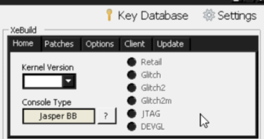

hello modding newbie here, just installed xexmenu and aurora and stuff on my decade old xbox 360 and i was trying to update the dashboard to the latest version, i was following mrmario's guide on it but when i got to the nand dumping part my xbox just wouldnt dump the nand when i pressed x as shown in his video, i saw another prompt to dump full nand by pressing B so i did that one and it dumped gave 512mb flashdmp back along with cpukey then i opened j-runner and loaded the nand and it detected my cpukey but the rgh,jtag and other things were greyed out after i loaded the nand, here is a picture of it, i imagine im not supposed to dump the fullnand but i didnt know what else to do :( any help will be greatly appreaciated.
by the way i launched dashlaunch and next to type was glitch2 if that helps, also my xbox is a phat model with a jasper motherboard

You can try power on the 360 with the eject button, that will launch Xell. If you have a network cable connected you can download a dump of the nand by entering the IP address displayed in screen in to your web browser.

thanks for your reply! i did what you said and downloaded all 3 files from my xbox including the flashdmp file and its about 500mb in size which seems like the same size as the one i got from simple nand 360, also after some researching it looks like my xbox has rgh 1.2 on it if that helps

update: i used the xebuild command line in j-runner and typed in "-t glitch2 -c jasper -f 17559 -p [insert cpukey here]" and it went ahead and gave back a updflash.bin at the size of 16.5mb, am i all good here? im afraid to flash this nand so im waiting for confirmation of it being good to go
