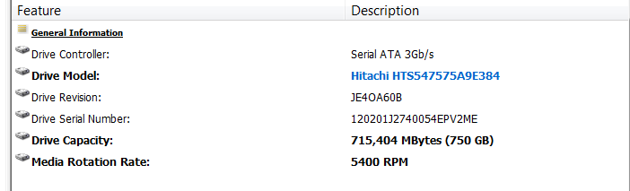

Will someone be able to tell me if the following drive could possibly work :
Drive Model: Hitachi HTS547575A9E384
Drive Capacity: 715,404 MBytes (750 GB)
I know it says clearly that only WD drives work, but I thought i'd give it a try.
Thanks
Thanks
Look under the faq section there is a link to a tutorial that might work.
