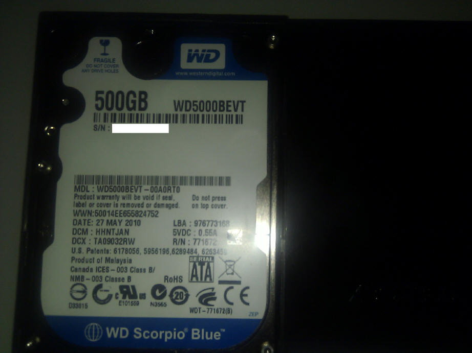

Here is Undo.bin from my hard drive WD5000BEVT (WD Scorpio Blue)

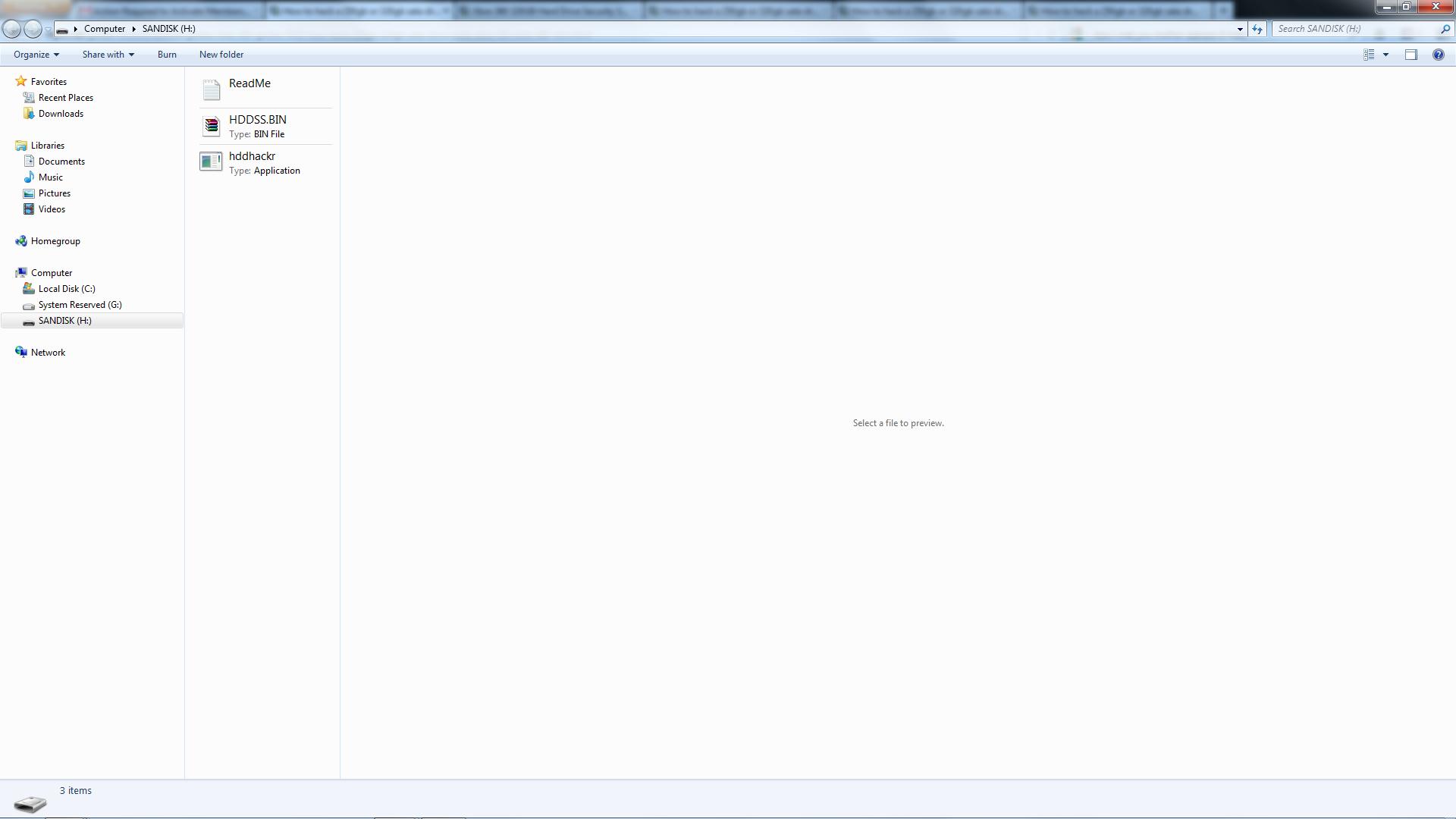

I was trying to do this on a 320gb Western Digital Blue (WD3200BPVT) hard drive. But when I in hddhackr and trying to flash the firmware the comupter says file not found for the hddss.bin. I have already done this on a 250gb hard drive and I thought it would been as simple as replacing the original 250gb hddss.bin file for the 320gb file. But for some reason the computer says the file is not thier. I am using the same computer as last time I did this.

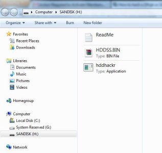

sandisk contents.jpgthe bootable usb contents

Alright, I did what you said and its a no go..
I took pictures with my camera while I was doing this so I can make it easier.
So Heres what I did.
I took a 2 gb flash drive, Using the USB bootable software I made the file format FAT and selected bootable from DOS. I took shut off my laptop, took out the battery and replaced the hard drive with the one i was going to use on my xbox 360 slim. I then pressed Esc key on boot up and it brought me to a menu about system information, system diagnostic, boot options, BIOS, and system recovery. I pressed Boot Options and it asked me what i wanted to boot from, I pressed CD/DVD as the flash drive never came up. I typed hddhackr when the windows mellenium emergency mode came up. nothing happened. so i tried it from booting from the new hard drive, same thing nothing happened.
I then restarted the computer, I pressed esc key on start up again. I clicked BIOS now. InsydeH20 Setup Utility came up (I took pictures of all the pages I thought was relevent). I believe this is BIOS, I cant find anything else about it. I can't find anywhere on there about RAID, AHCI, or IDE.
