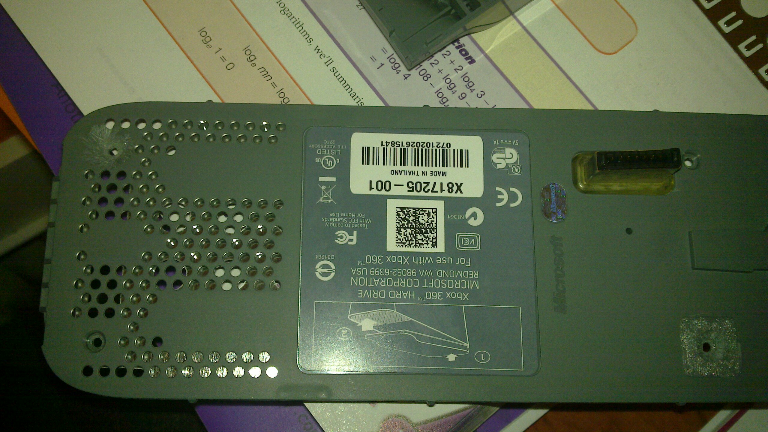

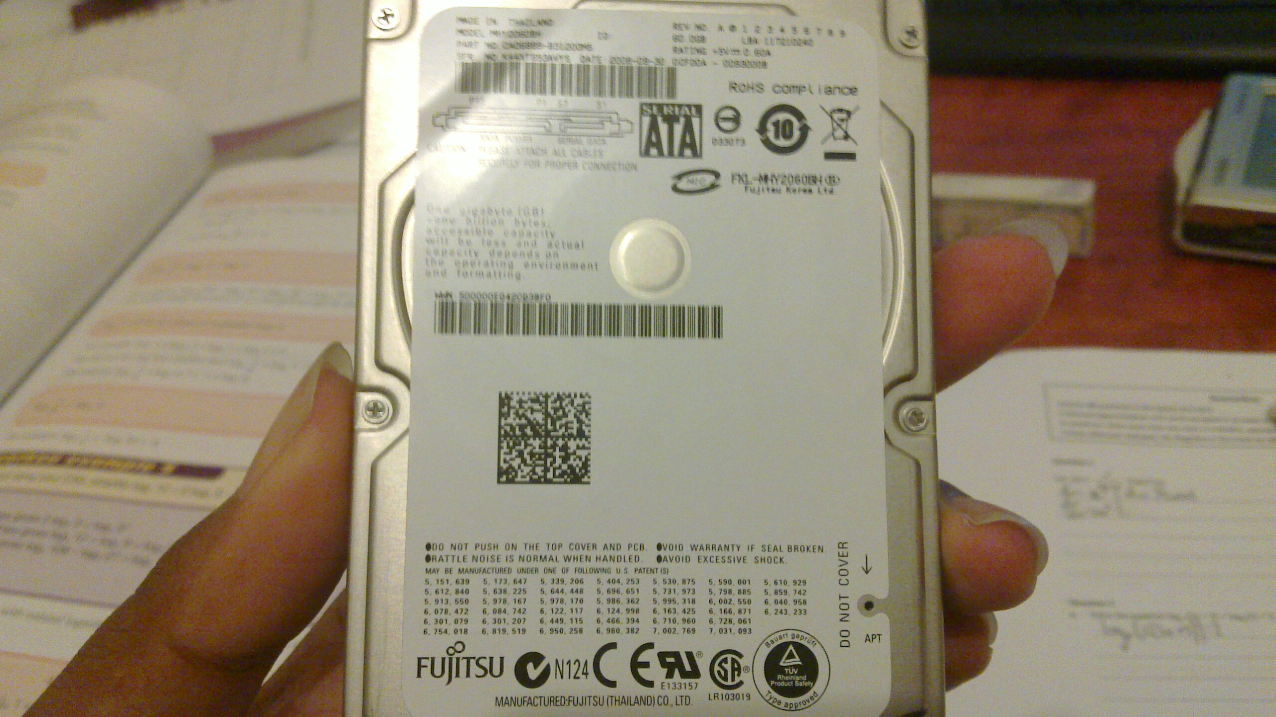

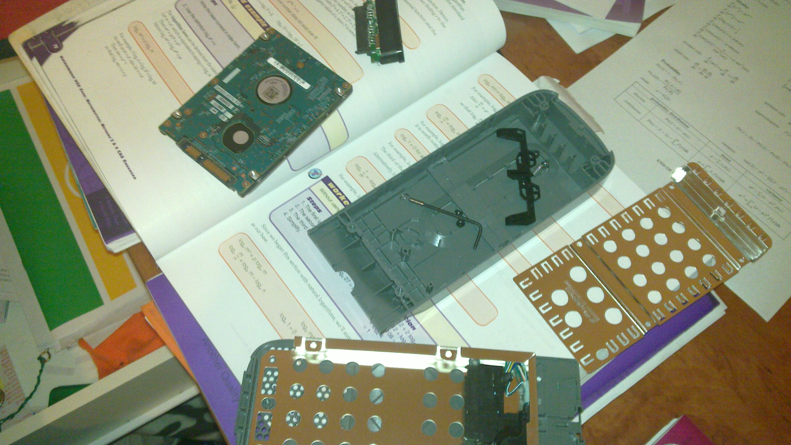

Hey nutter and rick, just to let you know when i took apart my HDD i was expecting to see a WD HDD inside, but to my surprise i found a fujitsu HDD in mine, so thus im guessing that HDD hacking is actually not limited to WD hdds, but Fujitsu ones to even though there is no actual files for it.
Heres Proof

Is that a retail ms hdd? They have some tool that creates these hard drives. WD is much better to use imo.
Yes it is a retail M$ HDD came with my 60GB pro console which i got approx 3-4 years ago, im trying currently to get in touch with TheSpecialist to see if i can manually hex edit the sectors so that fujitsu can be used to boot
Retail Xbox 360 hard drives have been various different brands over the years, I have a 20gb Segate and Samsung here.
Its only Western Digital drives you can hack your self however.
From the Hddhackr FAQ:
Q. Could you do this for my Seagate, Maxtor, Samsung or whatever drive too ?
A. Yes, but I don't have plans to do so. It is a lot of work to convert this tool for usage with other brands and don't think it is worth the trouble.
