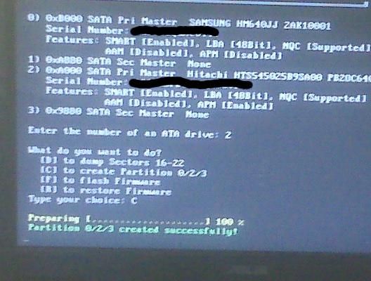

If you create the partitions manually it should work fine, in Dos run the command "HDDHACKR C 0960 A0" where 0960 is the port the drive is on.
This port can be seen when loading Hddhackr like so, in my photo its next to drive 5:
OK...So I did exactly as you said to do it....
HDDHACKR recognized drive as the Hitachi....
see screen below....
BTW..I have two versions of HDDHACKR on my USB...I renamed V1.3 HDHACKR that is why it says HDHACKR on the screen....
Turned laptop off...unplugged the drive...put it in it's xbox case, slipped it into my 4G Slim and turned it on and then I got E68.....
I must be missing something....omitting a crucial step....

Thanks...I made sure, and then double, and triple sure it was seated fine...even took a flashlight and inspected the drive bay.....
I reflashed the HDD back to original...wrote zeros to drive and then then reflashed with 250gb bin....but it never prompts to partition....always says succesful! will now work in xbox360...so then I manually partition it it and it says successful too....however the xbox360 4G will always E68....
I've actually done this several times..and the same results.....
Whoever wrote the program should know why it won't prompt you to partition...for some reason something is causing the program to skip over that part of the code.....

When i tried to use it. It was able to flash my HDD just fine, but it didn't ask me for my partitions that i wanted it to use. So i went back in there, and i attempted to make it do so manually. I went back into it, and told it to create it via C. After doing that it does what it shows here. But it never goes away. After sitting there staring at it for 30min i gave up on it. The flashing seemingly works since when i trid it in my 360 it showed up as an unformatted drive.
attachment.php
But it stays like that and doesn't seem to be working. My BIOS' settings for IDE is compatible since that is the only thing i could find that was close to completely removing sata and able to hopefully work with XP and older without a hitch. And that si the only option in my laptop's bios with things related to that. The second drive is obviously the flashed hdd. It was a WD scorpio blue WD2500BEVT since it says that that drive works here i got it.
Now then, with that said, has anyone else had this issue with it not wanting to create the partitions? If it refuses to create them, then i guess i'm left with an empty drive that I won't use, since the only other way that i can imagine to partition it is via teh 360 itself which will probably lead to tons of problems down the road. It probably would be able to do that, but I'm not going to risk it. Also when i did click on it just to see what it'd do it asked for the console's SN. I instantly left it since i felt like it was MS attempting to get the stupider of people to give them the console ID with which to ban the person for using a non-standard HDD(whcih i don't know how they'd be able to tell that since the firmware apparently makes it think that it is legit.)
