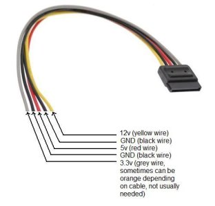

  19. Marius517
    Marius517 New Member
    Aug 19, 2014
    4
    I have 1 spare wire like this sata_power_cable_pinout.jpg (it doesn't have the grey wire)
    Is there a way to connect it to 2-3 usb cables to power it(i don't use the back usb ports.. so why not)? From what i know Y usb cables are capable of powering a 3.5" HDD.
  20. InsaneNutter
    12,565
    3,872
    I personally don't know how you could do what you want, 3.5" drives can draw 15w+ when powering up, so even 3x usb ports powering the drive might not be enough. You would need to power the drive from an external power source i personally think, or do the mod i liked to in the post above.
