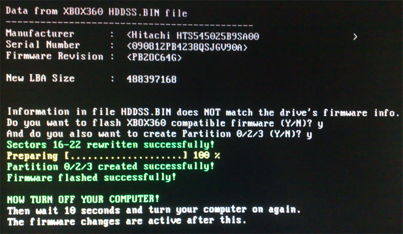

    so i tried to format the HDD again before i do the partitioning... after i enter my serial num it shows a progress bar that is automatically halfway full, after about five to ten seconds it freezes for a couple seconds then the bar is full but jumps me back to the list of mu's and still says unformatted! i can do it over and over again it will do the same thing but if i shut the xbox off again it formats...seems like every other time it will format...and one more thing after looking at the pictures on this tut hddhackr6.jpg .my hddhackr never even gave the option of partitioning 123 lol

    So far its stayed formated after restart I did the partitions also one question hackr said my LBA size was unsupported any clue what that means?

    Maybe the hard drive is bigger than the bin file you used,either 250gb or 320gb
