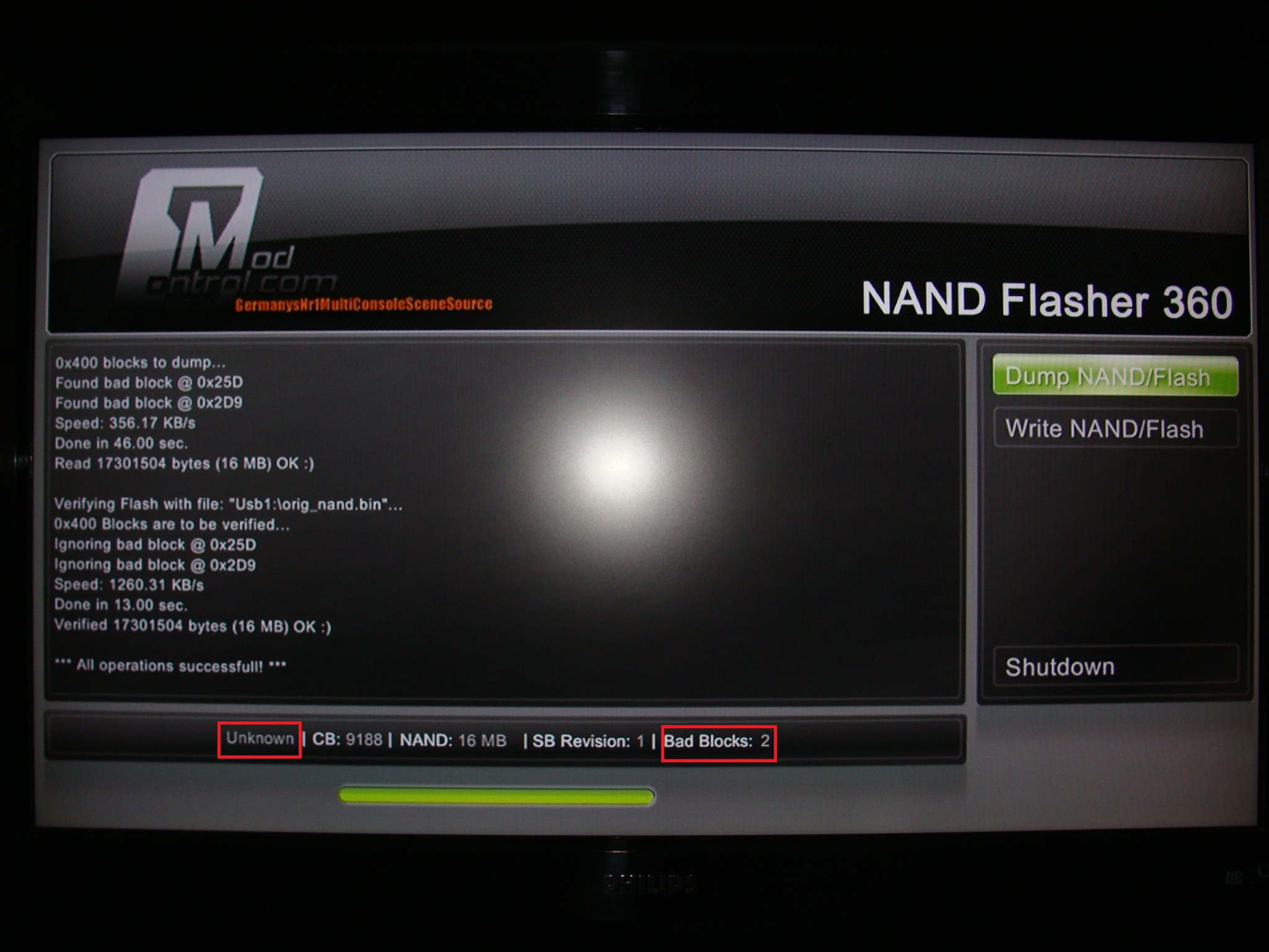

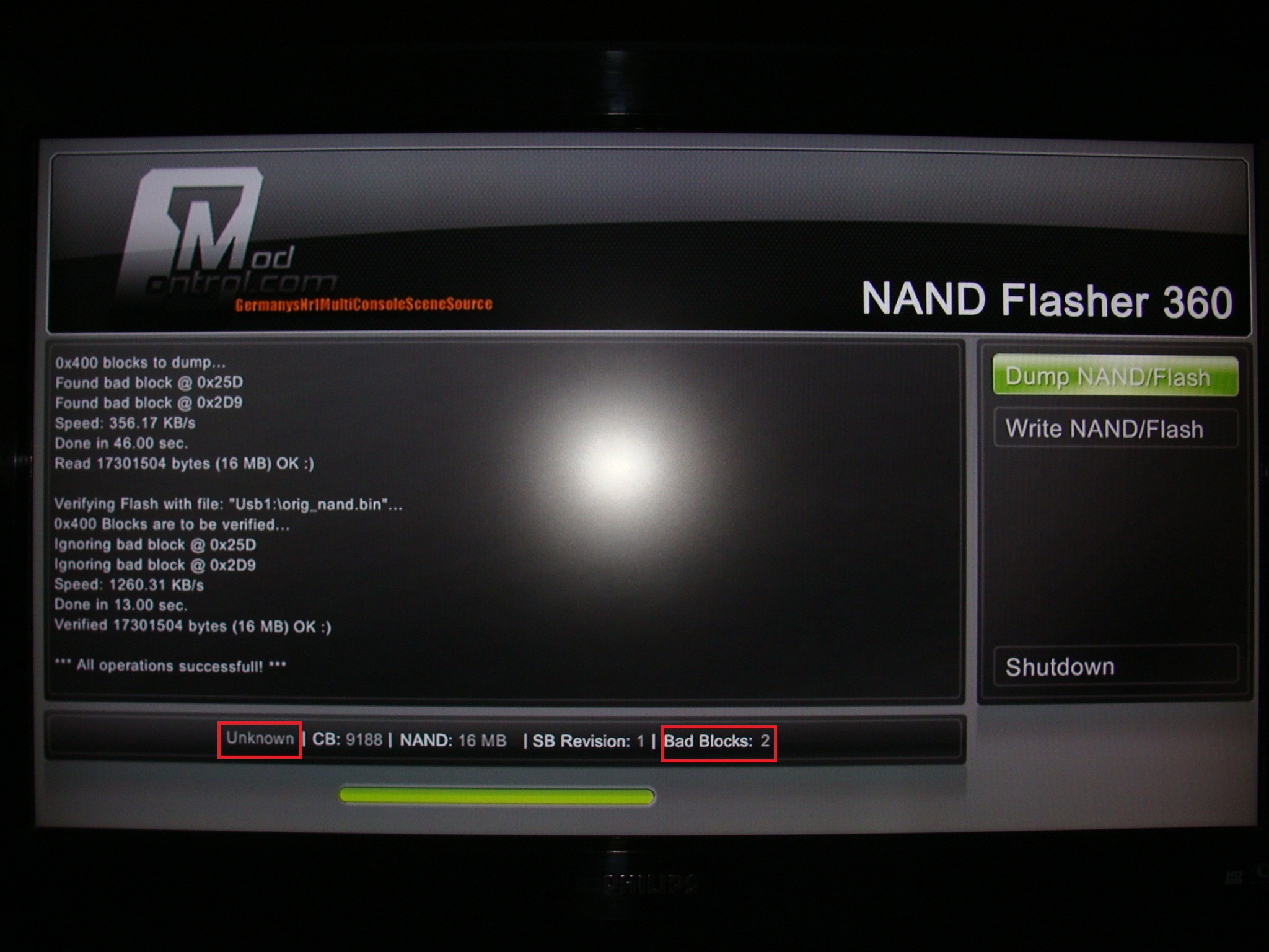

    Personal beauty need help, I'm trying to update my dash and the new hack tb.
    I had my Nand nor Cpukey to and I could get the key booting Xell pressing the eject button and pick up the nand NAND Flasher 360, only when the NAND extract the name of my xbox appeared Unknown and had two bad blocks.

    Everything is alright, NAND Flasher 360 doesn't know about slims yet, however it works just fine with them. As for the bad blocks, they get remapped when you dump the nand, so you shouldn't worry. Just follow the tutuorial and you'll be ok.
    EDIT: also, even you have a nand dump with bad blocks, xeBuild remaps them also, so there is really nothing to worry about.
