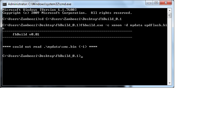

    I have problem with SMC with using original nand
    fbBuild v0.11
    ******* ERROR: you are using an unhacked smc.bin!
    ******* : you require a JTAG hack SMC to run the exploit!
    Please help

    Hello,
    I am currently trying to update my falcon and I'm experiencing the same problem as this person. Is this because of the way the Jtag was wired? Aud-clamp?
    Any thoughts on this would be greatly appreciated, thanks

    Are you both using a decrypted SMC.bin?

    Sorry I'm quite a noob when it comes to this sort of thing.
    So far I have backed up my Jtagged nand image with Flash360 as I don't have my original and have used 360 Flash Dump Tool to obtain smc_config.bin, KV.bin and smc.bin
    Hope my info helps
