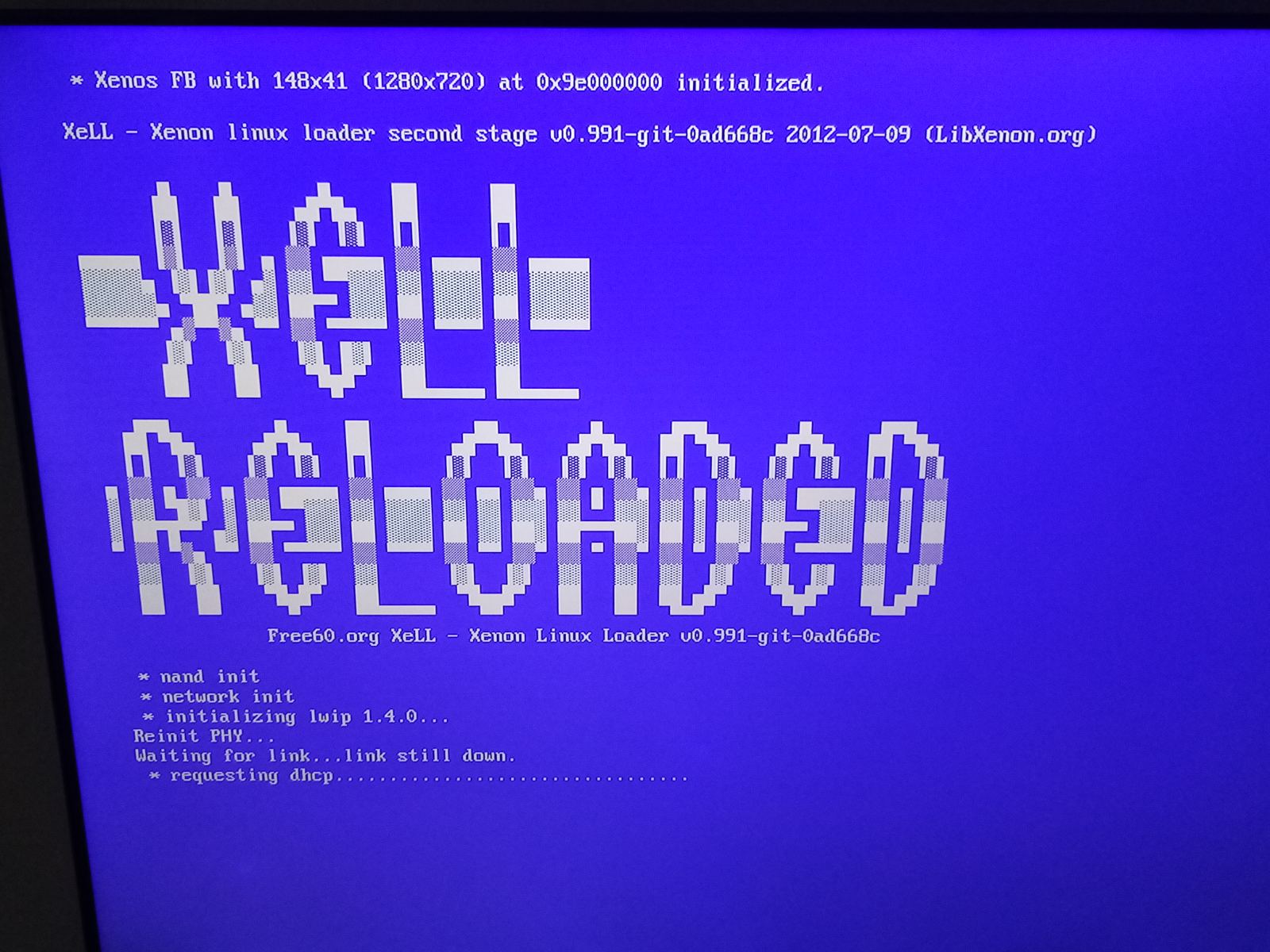

I suspect Xell is actually running when you power the console on with the eject button? i presume you are just getting a blank screen? if so and you have a network cable connected your router should give the Xbox 360 an IP address, so you can access the console via a web browser using this ip address (for example http://192.168.1.111) to obtain the CPU key, and so on.
How can I know if the console is running the Xell ? I never saw the Xell screen before and never used it. I connected the VGA cable like you said in the tutorial for the first time in the console to see if I could see the Xell screen but nothing happened. Is there some configuration to get Xell running, like a specific place to put it in the Xbox 360 storage devices ? My Xbox 360 is connected via WiFi in the network, does that work too or do I have to get a cable to do what you mentioned ?
Power the console on with the eject button, Xell should load. Ensure the network cable it connected, then you should see an ip address in the network config:
11600d1349157999-easily-update-your-jtagged-rgh-xbox-360-kernel-dashboard-14699-xebuild-img_20120927_230702.jpg
Using your web browser on your PC go to http://192.168.1.99 or what ever your consoles ip address is, you should be able to download your "raw flash" from the console.
Do that and use it as your source nand to build a new image, after that has done flash it to the console as before and hopefully that should stop it from freezing.
