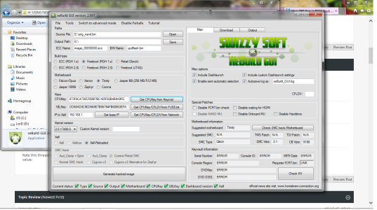

Wanna ask you another question it's a bout building the new (update) with the nand,
I don't have the original Nand anymore so I made a copy of the nand thats in the xbox now,
When I was looking for my CPU key, I found in XEX loader I also see info over the glitch,
the info said glitch 2, but when I load the nand in Xebuild it automaticaly goes to freeboot glitch 1.0
is this correct or must I change it in glitch2 ?
In my experience XeBuild Gui usually picks the correct settings based on your nand, i'd be tempted to believe that.

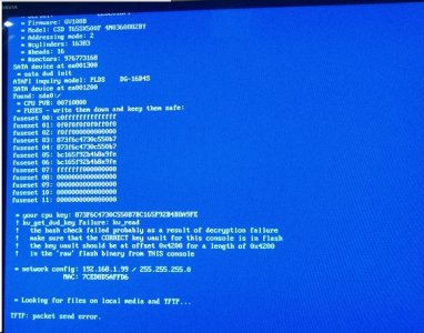

hi,my problem starting from not reading new games with dvd, till i decide to update dashboard, and now tis is second problem! what is wrong with my KV code? dasboard ver 16747
Is the problem you have after you have flashed an updated nand to the console or before?
i coulden't have flashed any update...just dumping nand as you did tut.
i purches my xbox from china and it was full of games so never tryed DVD till now. but i am sure they did every thing on this BOX.
thank's for care pal.
