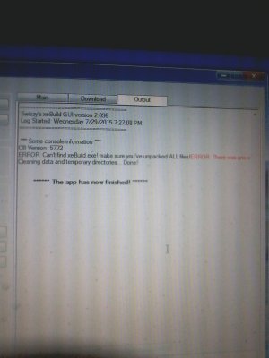

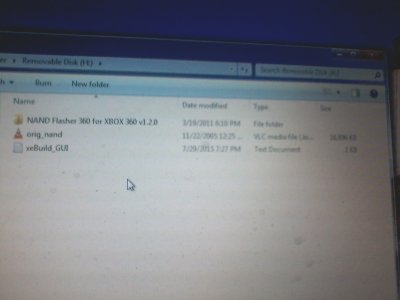

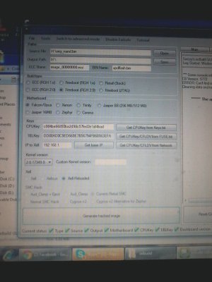

After genrating hacked image the error occured
It says "there was one more fatal errors: 1 error during build proccess"
What i should do now
I have RGH!!
PLZ help :(
What are the errors? you should be able to see the log in the "output" tab in the top right of XeBuild GUI.
I am sending you pics.
Hope,it will help you to understand better.

Re download xeBuild GUI 2.096, the error is saying you have some files missing from xeBuild.
Also if your running it from a USB drive, load XeBuild from somewhere on your C:\ drive.

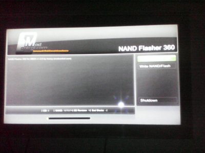

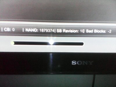

He downloaded nand flasher 360 and open it and when he tried to dump,error occured.
Two bad blocks found
And no nand found.
What we do?

Don't worry some bad blocks are normal.
Let the Nand finish dumping, then build the new nand with XeBuild GUI as before. XeBuild should re-map the bad blocks automatically so you dont need to worry about that.
Then simply flash the nand with Xell (powering the console on with the eject button and having the new nand on a usb drive).
