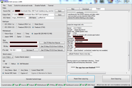

    I dump my Nand and generated a new one, this is what it looks like.. I am concerned about the
    CF LDV and especially the KV Type which are both different from your sample screenshot.
    Is this anything I should be conerned about? Should I go ahead and flash my xbox with this generated nand?
    Thanks for your help
  13. InsaneNutter
    12,567
    3,872
    That's perfectly fine, all these will be different depending on the Xbox 360 been updated.
