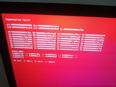

    e-71 error after update
    hi, i just recently followed the guide you just wrote, but unfortunately after the last step, when i plugged in my xbox. after the xbox logo, it goes on e-71. any chance i could still revert to the old setting?thanks in advance!

    yes, i could still power with the eject button. but after a while it turns red with what looks like an error message. can you give me a 101 on how to ref lash it back to existing nand?
  16. InsaneNutter
    12,567
    3,872
    It sounds like you cant load Xell, so the only thing you can do now is solder a hardware nand flasher to the motherboard of the Xbox.

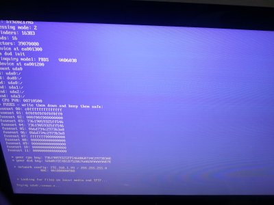

  17. stellarskymind
    stellarskymind Member
    Dec 19, 2013
    5
    first that comes on and then this....
  18. InsaneNutter
    12,567
    3,872
    Format your USB memory stick as FAT32, rename your nanddump.bin to updflash.bin and power on the console with the eject button and it should flash your console back to your working nand backup
