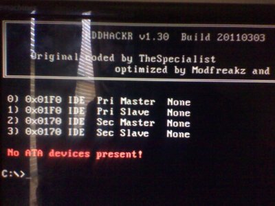

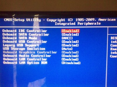

    P010713001.jpg P010713002.jpg Hey sorry for the late response....but i broke my phone...anyways...this is what i see in my bios and when i run hddhackr....HELP!!!

    Try changing onboard sata from ahci to ide
  14. Bartman
    Bartman Member
    Jan 6, 2013
    12
    Yes, just make sure to change it back to ahci before booting back into windows
  15. AnimaulKing
    AnimaulKing Member
    Dec 21, 2012
    8
    ok i just did that...no go
    i have three options when i try to change that....achi, native ide and raid....i changed it to native ide and im still getting the same message as the picture i posted....no ata devices present
    But i noticed something....when i leave my main hard drive (the one the pc runs off) connected to the motherboard it will be detected by hhdhackr but my 250gb will not
    i know my drive is good because im currently using it as an external 16gb for my xbox

    others have mentioned that disconnecting everything and only having one drive (the xbox drive) connected may work.. but everyone milage will vary

    nah i think he meant disconnecting the main drive and leaving only the drive u wanna flash hooked up
    oh and when u changed to ide in bios, make sure u saved settings...ive done that a couple times where i accidentally just exited without saving
