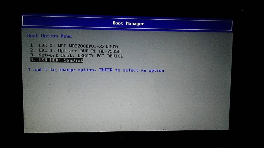

  4. Pearlized Pistol
    Pearlized Pistol Member
    Jan 3, 2013
    10

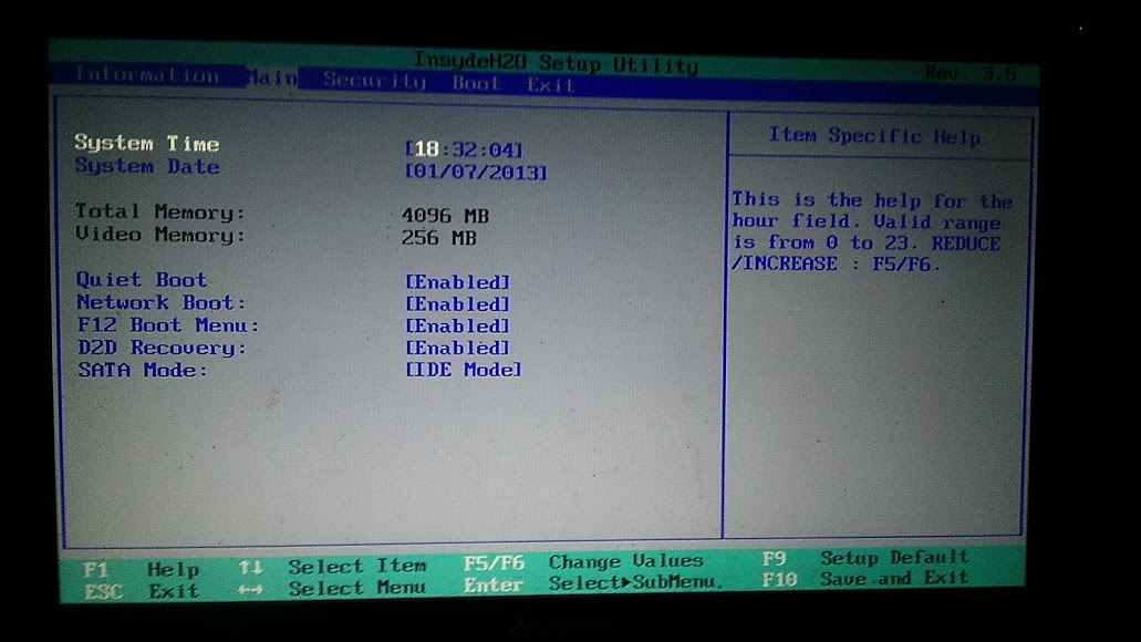

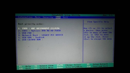

    Updated my BIOS and still no good... Maybe "Raid" is enabled..? I don't see an option to turn that off... Could that be listed as anything else in the BIOS? I know, noob question, but bear with me <.<

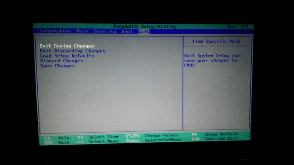

    Anything like raid. legacy . ide .sata .ahci. If you can post pictures of the bios, that might help.

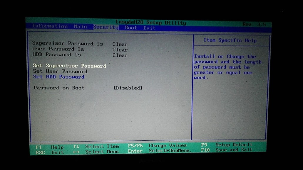

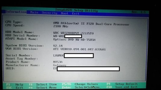

  6. Pearlized Pistol
    Jan 3, 2013
    10
    Photos of me looking through BIOS, then attempting.

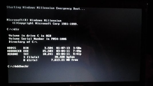

    After looking at your previous posts. Are you still having the issue in bold below? Try typing in hddhackr.exe
  10. Pearlized Pistol
    Jan 3, 2013
    10
    Yeah, same issue... BTW, I typo'd in that one post, not when entering it in on the boot menu for hacking the drive... If I typo it on the boot menu, it just says "bad command or file" and I can try typing it again... And if you look in my screenshot, I typed it correctly. I've also tried it with and without .exe on the end, and in all caps and all lowercase... Nothing helps :(

  13. Rick
    Rick Moderator
    2,852
    1,288
    Im thinking it has to be a bug with dos and different bios.I will look into this and post a list of fixes that might work.
  14. Rick
    Rick Moderator
    2,852
    1,288
    Try these.
    1.Change usb dos creator folder.
    -Select the box with 3 dots and choose the USB Drive Boot Files\MS-DOS folder as the location
    -Instead of ms-dos, select folder FreeDOS
    -Copy hddhackr & hddss.bin to the usb
    -Press enter when it asks for date & time. When C:\ shows up, type in hddhackr.exe or hddhackr
    2.Try creating the usb dos with this. Boot and Run DOS from USB | USB Pen Drive Linux
    -copy hddhackr & hddss
    3.Use a different usb drive.

  18. Mantas Jotautis
    Mantas Jotautis Member
    Oct 8, 2012
    10
    succeeded with FreeDOS hacked hdd like you said;). How will it be done only at the MS-DOS and with FreeDOS. but nzn or hdd works because I do not have db xbox just weekend you can check, but when I combine hdd to pc and trying too Put your Xplorer360 Extreme2 me he can not find what to do? Do I need xbox formatted hdd?
