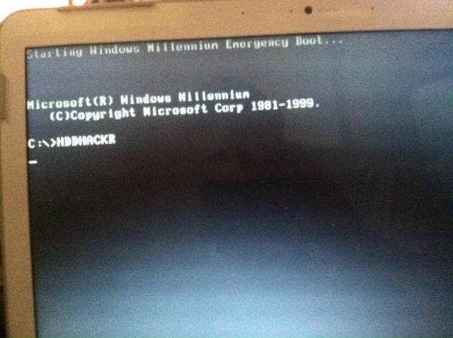

  11. Billy Briard
    Billy Briard New Member
    Feb 8, 2013
    3
    im having a issue im getting stuck at this screen
    i tried all i know how to do it just stays at this screen tho
  12. Rick
    Rick Moderator
    2,852
    1,288
    Recreate the usb drive with the free dos folder instead of ms-dos. Just hit enter when it prompts for date & time.
    You need a modified console for that.
