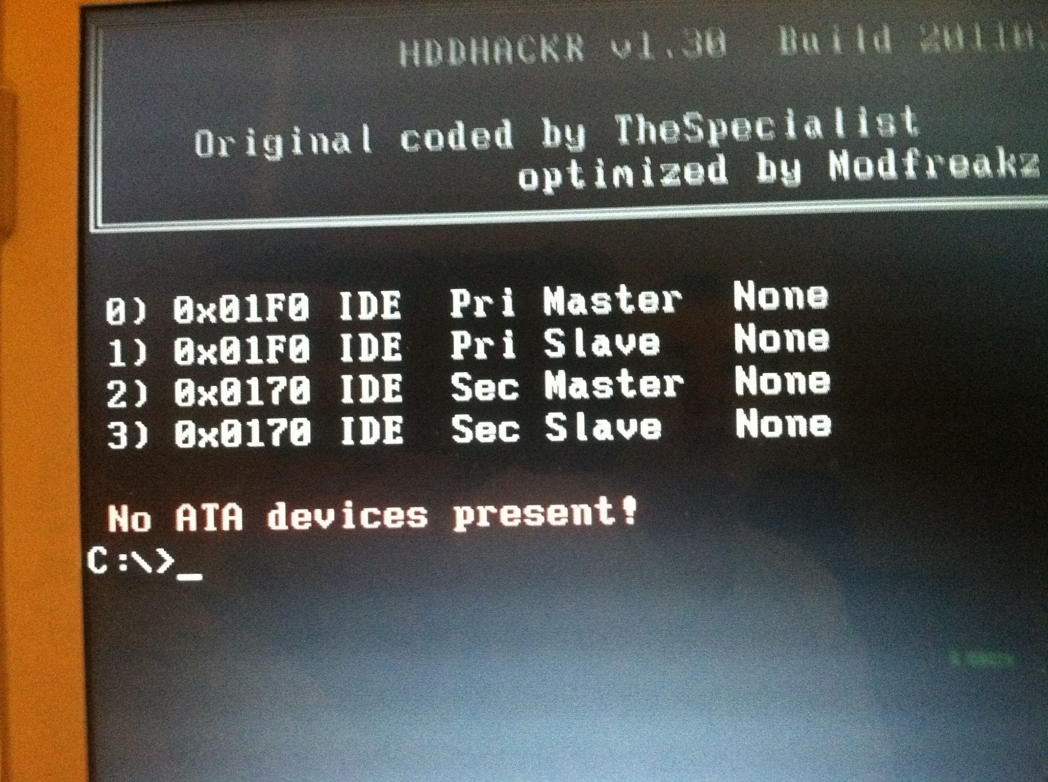

tried that and i got further but now it says No ATA devices present! i tried to make sure all plugs are in fully everything is but not working. D: im sorry im usally good with following instructions on computer stuff but i never have done this type of stuff before just little computer stuff lol

what do i do about the no ata available or whatever
try this :
unplug your windows hdd then plug your hdd in (that you want to do this tutorial with) in the same slots where your windows hdd was !!!!
then just put your pc back on and let it run you will see that it loads and then you will get the thing where you have to type HDDHACKR :p
