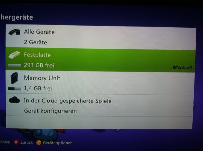

I srsly need some help here:
Used a WD3200BEKT 320GB - xbox360 slim
First off: when i use hddhackr (no matter if i use v1.3 or v1.4)
it doesnt automatically flash AND create partitions.
First i have to flash and then i have to create the partitions.
Result: xbox says: capacity: 294GB and free space: 129GB
please help me to fix this!

If you haven't transferred anything you will need to format it.
With the drive connected to the xbox follow these instructions.
To format a storage device
  1. Press the Guide button on your controller, go to Settings, and select System Settings.
  2. Select Storage or Memory.
  3. Select the storage device that you want to format, and then press Y on your controller.
  4. Select Format. You will see the following message:
    This will delete all content on this device. Do you wish to continue?
  5. Select Yes to format the storage device.
  6. If you are asked to enter your console serial number, do so, and then select Done. This step helps to guard against accidental formatting.
The console serial number is located on the back of the console and behind the oval door on the front of the console.
I already tried it. The progressbar is at 50% all the time and after 20-30 minutes I turned off the xbox. Shall I wait much longer? It seems so stucked :/
Thank you! Everything worked fine ;)
