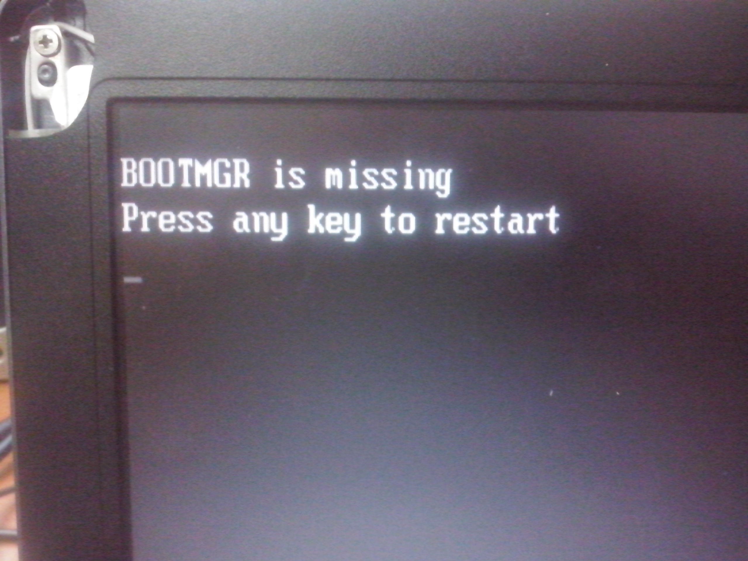

Hello, when I tried hacking my JHDD, I got this:
and I don't know what I did wrong, can someone help me?
Image is broken. Can you attach the image via go advanced>manage attachments>upload.
Im sorry for that
EDIT: I only get this when I put the HDD into my laptop but when I connect it as external drive it tells me there are no ATA devices present

Im sorry for that
Looks like the flash drive wasn't selected for booting. You will need to connect the flash drive with dos & hddhackr on it and connect the the hard drive internally. To select the usb drive for booting press the button for selecting boot device or you can change it in the bios.
When you're done you can change the boot priority(if you changed it) after you have hacked the hard drive.
