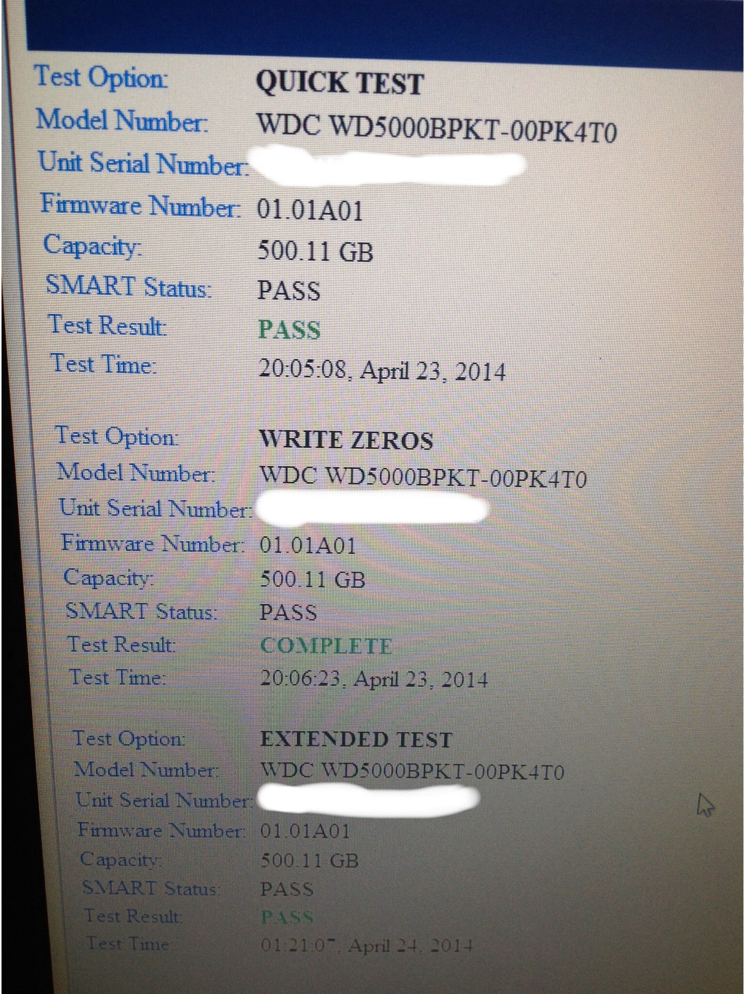

Undo the drive with hddhackr then try this. Use this tool in this thread to test/wipe the drive. Data Lifeguard Diagnostic For Western Digital Drives
Alright, so after testing it and writing zeros do I just re-hack it using HddHackr?
I attached a photo of the tests results.
