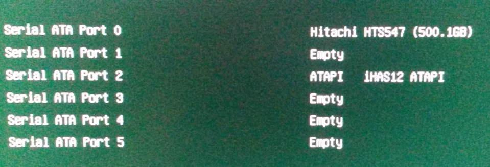

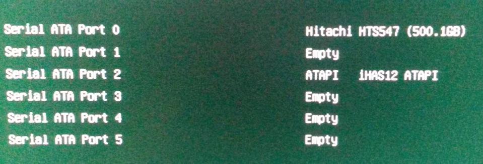

    Alright, noob here.
    After dealing with this evil that is windows 8, I finally got my usb loader to boot and i got HDDHACKR to run.
    The thing is, im using a usb to sata cable on my asus laptop, and in windows, the usb/sata hdd is recognized, but under HDDHACKR, it is nowhere to be found.
    When I open/run HDDHACKR, it shows the primary SATA device, which is my hard drive, and then 3 other empty sata connections.
    Is there any other information needed to help me troubleshoot my problem? Thanks!
  16. Rick
    Rick Moderator
    2,852
    1,288
    Hddhackr only works using a direct sata connection.
