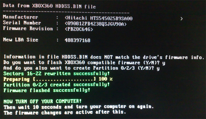

    when i use the hddhackr, all work perfect, exactly like this picture
    then i turn off the computer, wait 10 second, turn ON, wait a little... shutdown again and remove the disk
    i shutdown the computer with the power button, because there is no command in hddhackr to shutdown the computer..
    then i connect the hard drive to the xbox360, go to the memory menu, and nothing, no hard drive :S
