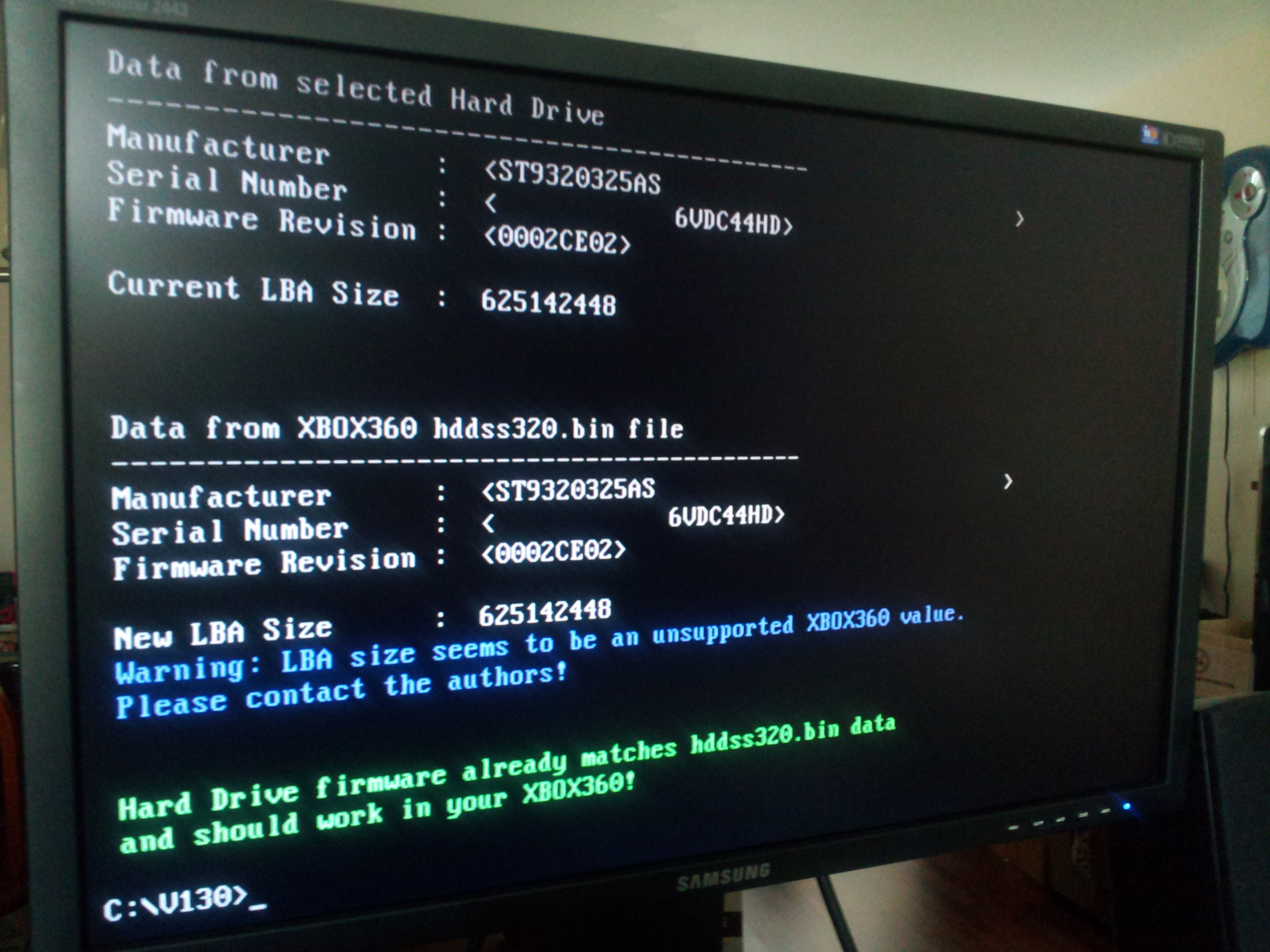

Hddhackr error on Scropion Black.
Hi,
I purchased a WD Scorpio WD320BEKT-60PVMT0 Manufactured Sept 4, 2011.
I have tried several versions of hddhackr and controllers with the similar results, but I will explain the issue.
I boot from USB.
I run the hddhackr v1.30.
I choose the SATA channel that the drive is on.
I hit F to flash.
I select the hddss320.bin file downloaded from this thread.
I choose a file name for the backup.
I get "Warning: LBA seems to be an unsupported XBOX360 value. Please contact the authors."
Also I tried with a velociraptor and the hddss250 and that works fine in the xbox, but needed an external power supply.
I can get the extact messages if you haven't seen these before.
I have also tried several motherboards, one being a P5N-D and external cards, they all detect the same and give the same warnings.
The drive is not detected by a brand new sbox 360 S 4gb.
Any thoughts?

You didn't follow the instructions.
Did you mean the WD3200BEKT? That's what I have.
I am not an advanced computer user, yet I followed the instructions and found the process easier that it actually looks.
The process worked flawlessly for me with the WD3200BEKT. Here's what you did different than me
NOTE: I got the LBA warning also (IDK why), disregarded it, then formatted in the xbox and everything worked fine.
1) You didn't you change the hddss320.bin to hddss.bin per the instructions.
2) You didn't partition the hard drive.
