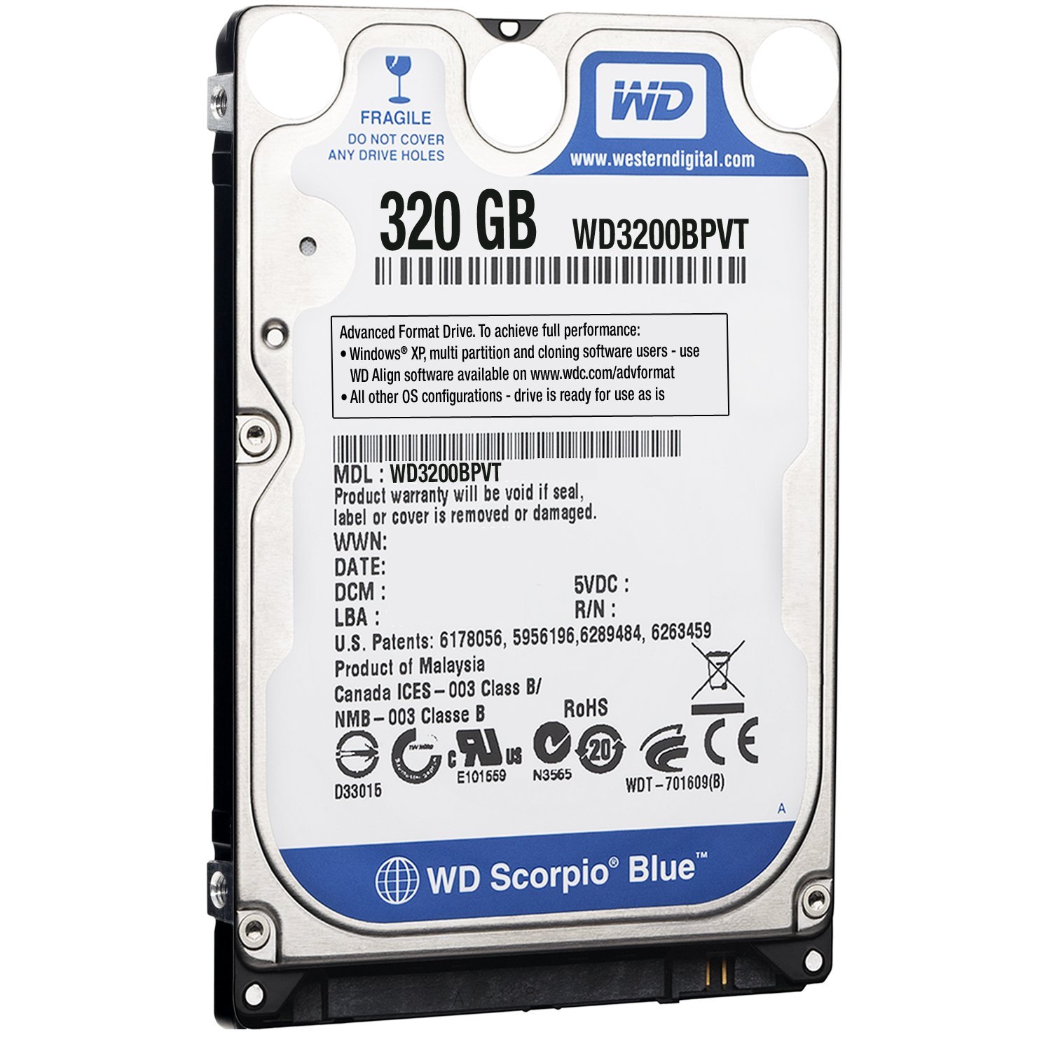

    will this hard drive work? i'm asking because it doesn't look like the one used in the tutorial. its a wd3200bpvt
  5. Rick
    Rick Moderator
    2,852
    1,288
    Yes it will work.
