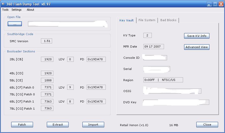

    please take a screenshot of your original nand opened in 360_flash_tool and paste here
  6. hucklebuck
    hucklebuck New Member
    Nov 13, 2010
    3
    What info do you need?
  7. sirleo
    sirleo Member
    Nov 12, 2010
    9
    for compare with our screenshots at page 2
  8. hucklebuck
    Nov 13, 2010
    3

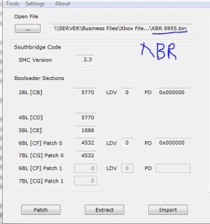

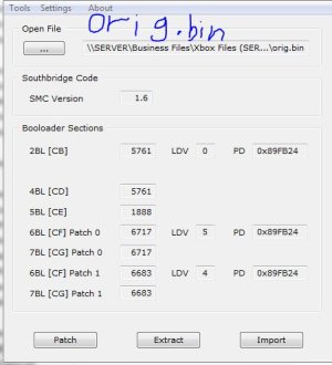

    I have the Alternate JTAG SMC

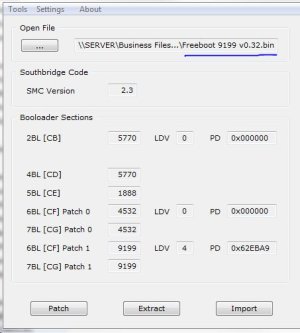

    I have flashed XBR 8955 with editing the SMC
    then flashed freeboot 9199 v0.32 went all fine

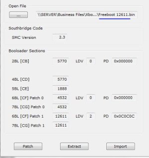

    now i am tryin to flash 12611 dash and using the freeboot nand but i keep getting errors
    if i do it this method in this tut when i power on the xbox i get xell come up with error request sense failed.
    I then tired the youtube video tut on the posts and i get e79 error because of the SMC but i ticked the box Aud_clamp Fix box so im not sure y im getting this :(
    Any hope Please!! i have flashed this thing like 20 times :( i dont understand y its not working.

    Use your working backup of XBR / Freeboot to create a hacked 12611 nand. You will have to flash it over USB or LPT though if you can not boot Xell.
