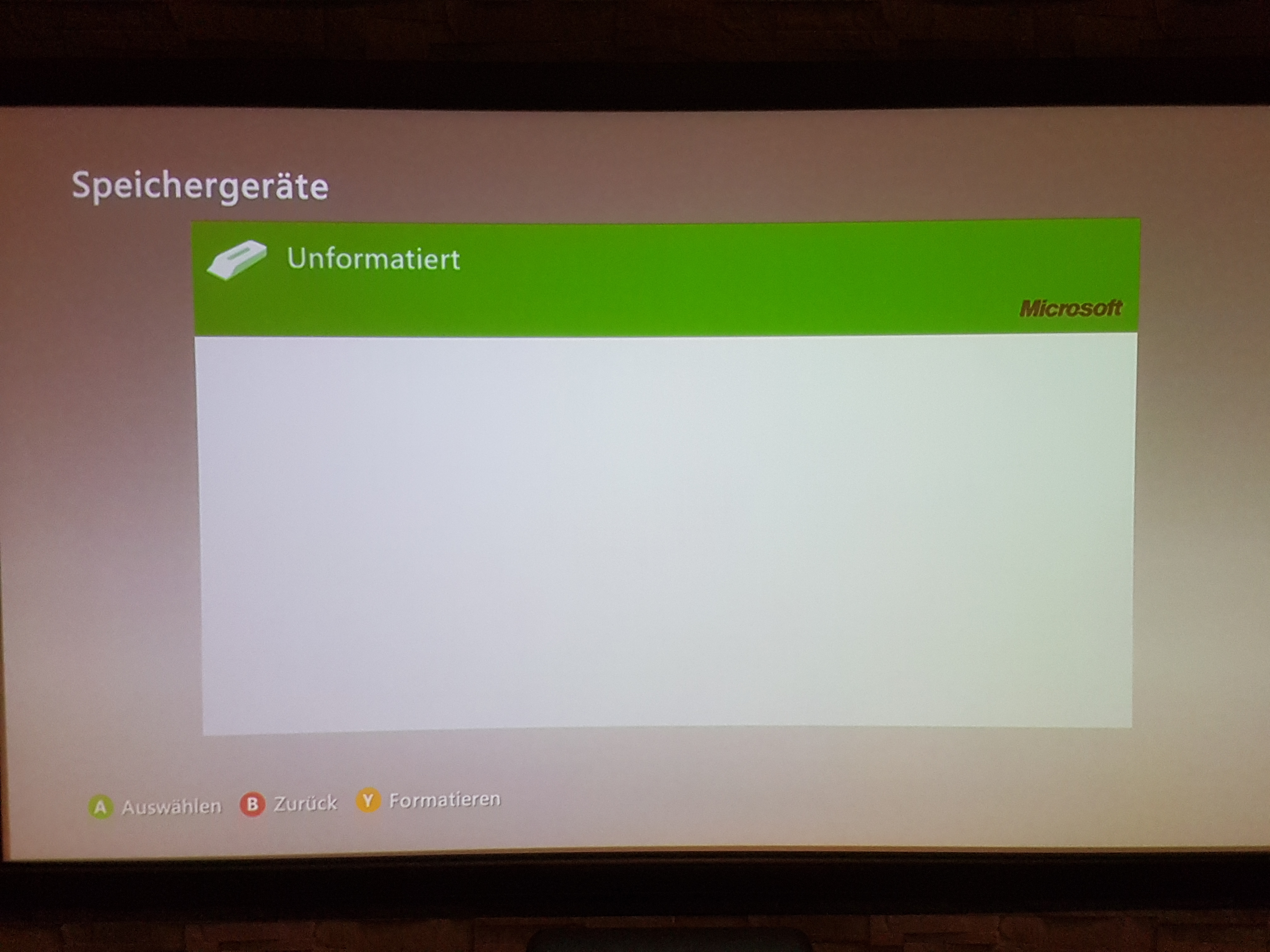

Hello, the Western Digital WD Black WD5000LPLX is not working.
HDD Date: October 26th, 2015 is the HDD too new?
It is not recognized by the xbox 360, but the flash was successful.
LG Ivan
Hi, help what am i doing wrong? AHCI is on and in the bios set to IDE only after the flash the hard drive is not recognized in the xbox 360 console.

Can you turn AHCI off? even though the Bios is set to IDE only? some newer PC's seem to suggest the drive is flashed ok then have issues sadly. The only device I have I know hddhackr still works with is an old Laptop from 2008.
You can use up to a 2TB USB drive with the Xbox 360 now for game / save storage just so you know. I kinda think that's a more viable option these days vs 500gb internal, unless you really want nothing to be on an external drive.
That was my mistake. I put it wrong. AHCI is set to IDE. The PC with which I made the flash last year performed a 250gb, 500gb and a 320gb hard disk from WD flash without any problems, but something is different this time or the WD5000LPLX is causing the problem. I don't have an Xbox 360 slim but the fat model. I don't want to use an external HDD. I don't know how it works with the 2 tb flash only the hddss.bin (500gb) Yesterday all data on the 500gb WD5000LPLX was completely deleted ( dariks boot and nuke) were still files from an old Windows system. (ebay) I will try to flash the WD5000LPLX back to the original state with the undo.bin in the hddhackr file and then flash the hddhackr again for the Xbox 360 to perform. After completely deleting yesterday, I still see the Hitachi disk in the bios so everything should have worked out. I will also try another hard drive case from the Xbox 360 fat model to rule out all errors.
From what you have said it certainly seems like it could be an issue with the newer WD Black WD5000LPLX. I'd certainly be interested to know if you can flash another drive though.

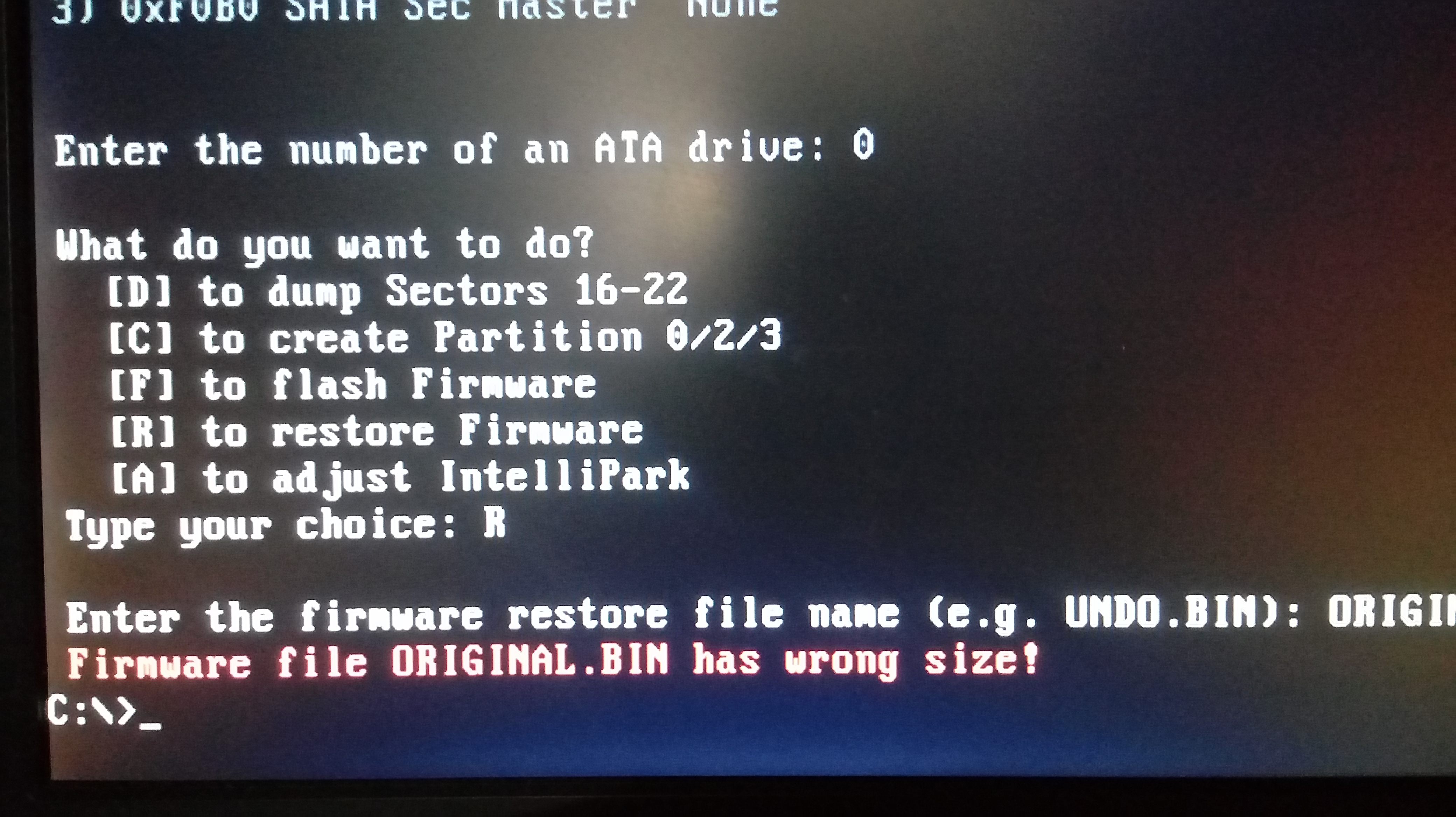

I just tried the WD Black WD5000LPLX again Flashing back to the original state without success the UNDO.BIN file was faulty. I'm not sure if I can set a drive back with Hddhackr, maybe I made a mistake. Now the renewed flash was also successful but in my Xbox 360 console I did not recognize several HDD-360 cases (Fat model) of the Xbox 360 and also two different Xbox 360 consoles without success. Will now get me a new WD BEVS or BEVT and flash it. I will report again.
IDE on and second Flash.

Have now received the WD3200BEVT and carried out the flash with the same PC. Date of the hdd 26 April 2010. As you can see in the pictures, it worked just fine. Then install the hard drive in the Xbox 360 and enter the formatted serial number. (See photos) I also installed a game to test everything goes, no problems. Will also test a WD5000BEVT if there is.
Then the problem lies with the WD5000LPLX.
Thanks for taking the time to test this out, i'll put a warning in the first post about newer versions of this drive.

Good night. My name is Luiz, I'm Brazilian and I don't master English but Google has been helping me a lot.
I registered to thank you for the excellent tutorial. I was wondering if you could solve a doubt and a problem I've been facing.
I did in a WD5000LUCT manufactured in 2019, everything went well, however, I got a 320gb and wanted to return the 500gb to normal tin. When I try to restore the firmware from this size error, written in red (image 1).
When I first did it, partitions 0.2 and 3 were not created... so I used the option [C]] and everything went well, works on Xbox but gave this error in green (image 2). Would that be a problem? The error appeared after I restored partition 2!!!
Could someone help me restore this HD to re-use it on PC?
ps. I have the backup of the original firmware of the hd WD5000LUCT made by HDDHACKR itself.
ps2. HD WD5000LUCT converted always worked great on xbox 360!
