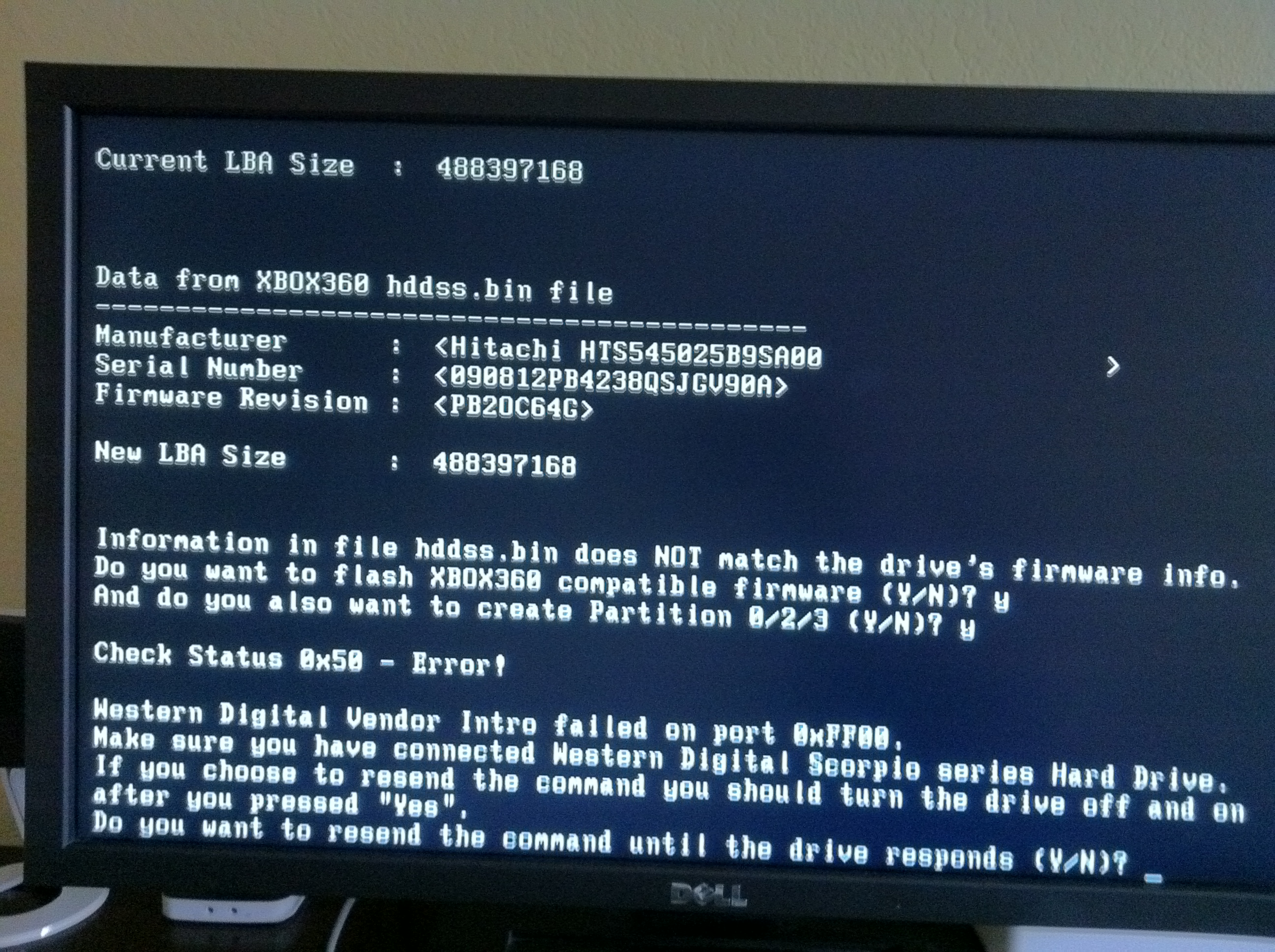

    I really need some help here guys, I've looked everywhere but I can't find a solution. I followed the tutorials but im getting this error(picture) Can somebody please help me? Thanks in advance! IMG_0046.JPG

    Hi danilo303
    I see your HDD is Hitachi.
    it must be Western Digital.
    in first page and several times after all the senior members said it must be western digital not Hitachi.
    hddss.bin cant be match with hitachi firmware.
    this hack work with WD HDD as listed in first post.

  19. danilo303
    danilo303 New Member
    Jan 2, 2011
    3
    Hi, Im using the Western Digital 250gb bevt...

    Hi danilo
    I saw the photo again. It is appear that the manufacturer is Hitachi. maybe u entered wrong number of SATA drive.
    be sur that u disconnected all of hardwares connected then connect WD HDD and try again.
    try to connect ur WD HDD to the same SATA cable that ur PC HDD is connected.
    be sur that u rename (HDDSS_250GB.BIN to HDDSS.BIN).
