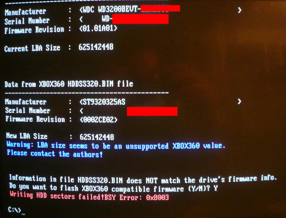

I'm trying to hack my new 320 GB WD3200BEVT Drive
When I try I get this error that: the "LBA size in unsupported" even though the .bin lba matches the drive lba
I tried to go ahead anyway and it failed.
See Screenshot: http://i.imgur.com/xYVEu.jpg
Now when I try again I get the "Reading sector 16 failed"
What am I doing wrong?

i managed to flashed both my BEVT and BPVT. both having the same 'so called' error message but i went ahead and flashed them. flashed successful. i amusing hddhackr ver 1.30 and via 6421a pci card.
See Screenshot:http://i.imgur.com/xYVEu.jpg
I found a third computer and it worked like a charm.
