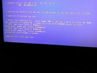

    Hi InsaneNutter,
    I think I am also having the same problem with forumer cncc , where the console able to boot up and show the xbox360 boot screen.
    The logo just stuck over there and I only can press home button to navigate Xbox Guide option
    Yes, I can access the Xell menu from my browser.
    I tried to use the same updflash.bin to update via Xell but the result is the same...
    Can InsaneNutter advice me what to do?
    try to boot up again and this time got a system update message ask me to perform update.
    So I copy the update 2.0.14699.0 to the USB and do update and hope it fix the problem
    turns out that I still get the same result. The system only boot up until the XBOX 360 logo, that's all
    EDIT - I tried to use a nand reader to read bad blocks, the original nand do not have any bad blocks. Scan the new created have bad blocks
    Edit 2 - Finally I manage to get it run !!!
    This is what I did ...
    Get the raw dump file from XELL , then load up the same program (xeBuild_1.00_f1) , rerun the same process.
    Get the generated file (updflash.bin) , put it in USB and flash again with XELL
    Once finish flashing , power down the console , unplug the power source from the power brick
    keep on praying for 2 minutes
    then plug in back everything and turn on your console
    P/S - to run XELL , i need to press the DVD eject button to turn on the system and run XELL
    hope this info helps.
