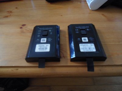

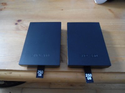

Which one is the original?
Can you tell me which one is the fake?
