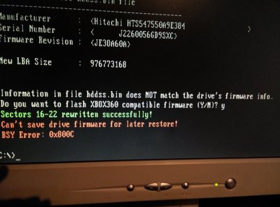

    Hello everyone, I have flashed many xbox hd for me and my friends, but they are two days that I have trouble flashing two 500GB hd LPVX series.
    This is the error:
    I wanted to ask if I can use on a 500GB hard drive, the file hddss.bin 320gb hard drive.
    In so doing turned it from 500 to 320 GB? Or it is not possible?
    Thanks for the help, and sorry for my broken english
  7. Rick
    Rick Moderator
    2,852
    1,288
    What does the drive show up as in the bios?

  9. r3lax1s
    r3lax1s New Member
    Nov 3, 2014
    3
    Naples,Florida
    In the bios the hd is properly detected, as sata drive.

  10. Rick
    Rick Moderator
    2,852
    1,288
    Does it have the label as WD500 or something else?

  13. r3lax1s
    r3lax1s New Member
    Nov 3, 2014
    3
    Naples,Florida
    Sorry if I reply late,but I was out of town for work.
    Yes, there is the label WD5000BPVT 500GB.
  14. Rick
    Rick Moderator
    2,852
    1,288
    Is that what it shows in the bios?
