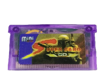

Dear, I use this Supercard
It's the same that our colleague has, I get it to load the ROM but I feel as if it doesn't have enough power to make the transfer because it makes a micro-flicker when I try to transfer the pokemon :(
I use the original and functional link cable and connect it correctly
I don't have a personal experience with this specific flashcart, but if there exist an option to use FLASH 128KB as save type (like in EZ Flash Omega) you should try it.
Another option is to try to patch the distribution ROM with this ROM patcher.
Thanks for the information but my knowledge is null for these things.. :( I don't know if I am able to convert the ROM in 64kb format.
